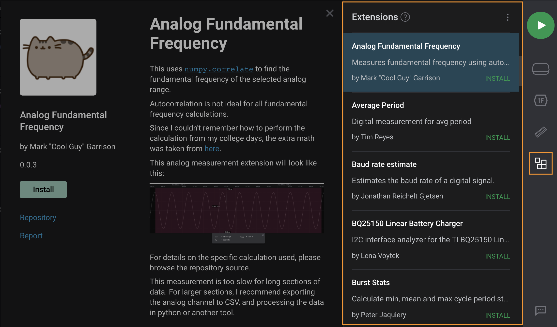

EditExtensions are Python modules that enhance the debugging process by providing powerful analysis tools on top of your data. There are currently three types of extensions available:
- High-Level Analyzers
- Analog Measurements
- Digital Measurements
You can browse available extensions and quickly install them from our Extensions Marketplace by clicking the Extensions button located at the right side of the software. You can also publish your own creation! Over time, we’ll be able to build up a collection of extensions. We can’t wait to see what kinds of extensions will be shared there.
