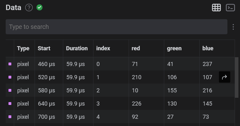

Additionally, FrameV2 objects replace the original Frame objects in the data table, allowing for multiple, user configurable columns, as well as a variety of data formats.

// New FrameV2 code.FrameV2 frame_v2;// you can add any number of key value pairs. Each will get it's own column in the data table.frame_v2.AddInteger( "index", frame.mData2 );frame_v2.AddInteger( "red", result.mRGB.red );frame_v2.AddInteger( "green", result.mRGB.green );frame_v2.AddInteger( "blue", result.mRGB.blue );// This actually saves your new FrameV2. In this example, we just copy the same start and end sample number from Frame V1 above.// The second parameter is the frame "type". Any string is allowed.mResults->AddFrameV2( frame_v2, "pixel", frame.mStartingSampleInclusive, frame.mEndingSampleInclusive );
// You should already be calling this to make submitted frames available to the rest of the system. It's still required.mResults->CommitResults();Screenshots:
