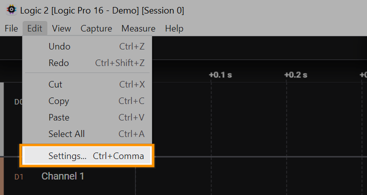

EditFirst, click the Settings button to open the Settings window.
- On Windows: Edit > Settings
- On MacOS: Logic2 > Settings
- On Ubuntu: Edit > Settings
Settings Menu
