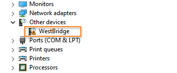

Device Shows up as WestBridge or unidentified device
A common issue in Windows is that the Saleae Logic may show up as a WestBridge or unidentified device in device manager. If this is the case, then there is a problem with the Saleae driver. Please install the driver per the methods listed in this support article.
If the drivers are installed properly, you should see Saleae Logic X USB Logic Analyzer in Device Manager, where “X” is the specific product version (4, 8, Pro 8, Pro 16).

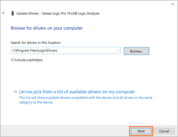

Method 1: New Hardware Wizard Installation
We want to get to the new-hardware wizard for Logic. Please connect Logic to the PC and open Device Manager. In Windows 10 and 8.1, you can right-click on the Windows logo in the lower left and select Device Manager.
In Device Manager, Logic might show up right away as an unknown device with a warning icon next to it. Right-click this and select Update Driver.
Select the second option for “Browse my computer for driver software.”
Use the Browse button to direct the driver wizard to the Drivers folder, which is detailed above under the section titled Location of Driver Files.
Click Next. If this fails, continue below.

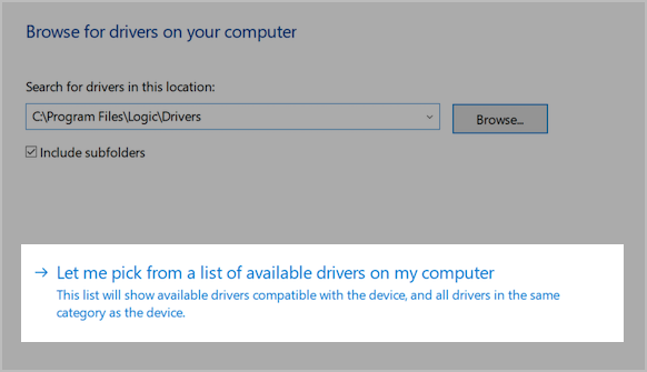

Method 2: “Have-Disk” Manual Installation
Open the Device Manager. Right-click the Logic device and select Update Driver. Click “Browse my computer for driver software.”
Click “Let me pick from a list of device drivers on my computer.”

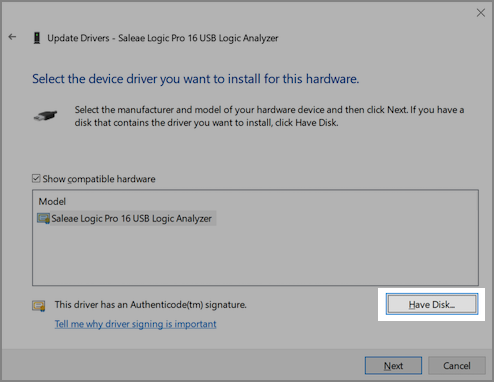

Now you will be presented with a window like shown below. Click the “Have Disk…” button.

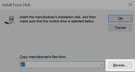

This will open the install from the disk window, which will assume that you have inserted an installation disk into drive A with the drivers. Click browse, navigate to the drivers folder, which is detailed above under the section titled Location of Driver Files, and select Saleae.inf.

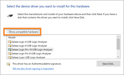

At this point, you should see either just the device you have connected or both Logic and Logic16. See below for details before selecting the device you are using.
If the checkbox for “Show compatible hardware” is checked, only 1 device should be shown. If it is not the correct device, then uncheck it to see all available Saleae drivers, as shown below.
These are all of the drivers that are included with the latest beta software, which you should see in the list when the checkbox for “Show compatible hardware” is not selected.
Saleae Logic 4 USB Logic Analyzer
Saleae Logic 8 USB Logic Analyzer
Saleae Logic Pro 16 USB Logic Analyzer
Saleae Logic Pro 8 USB Logic Analyzer
Saleae Logic Start USB Logic Analyzer
Saleae Logic USB Logic Analyzer
Saleae Logic 16 USB Logic Analyzer
It’s VERY important to select the correct product. Selecting the wrong product will cause our software to download the wrong firmware image, causing undefined behavior.
There is some naming confusion here that I would like to clear up.
If you purchased the Logic 4, the Logic Pro 8, or the Logic Pro 16, please select the driver that matches the product name.
If you purchased the new Logic 8, our logic 8 channel logic analyzer with digital and analog, released in September 2014, please use the driver “Saleae Logic 8 USB Logic Analyzer” and NOT the driver “Saleae Logic USB Logic Analyzer.” If you have the original Logic unit, 8 channel, digital only, discontinued in mid-2014, please select “Saleae Logic USB Logic Analyzer” and not the one with the number 8.
The original Logic 16, also discontinued in 2014, uses the “Saleae Logic 16 USB Logic Analyzer” driver and NOT the pro version.

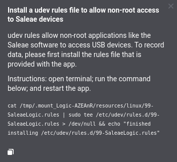

When the Logic 2 software is opened, a udev rule file is checked. If the udev rule is missing, then an error message will popup to prompt you to install the proper udev rule file. The good news is that, if you see this popup, then our software was able to detect the device. Follow the instructions to open the terminal and run the command to install the udev file.
Instructions:
- Ensure the Logic app is running and your Logic analyzer is connected
- Open terminal
- Run the command below (replace “xxxxxx” with the characters shown in your “Install a udev rules” popup window)
- Close the Logic app
- Log out & log back in to your PC
- Disconnect and reconnect your Logic analyzer
- Open the Logic app
cat /tmp/.mount_Logic-xxxxxx/resources/linux/99-SaleaeLogic.rules | sudo tee /etc/udev/rules.d/99-SaleaeLogic.rules > /dev/null && echo "finished installing /etc/udev/rules.d/99-SaleaeLogic.rules"
