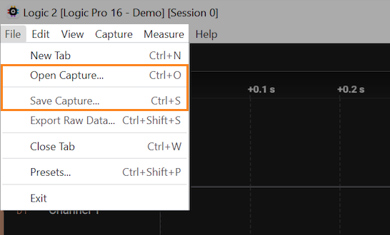

To save your current capture tab, click File > Save Capture. To open an existing capture file (.sal file format), click File > Open Capture.
Saving and opening captures

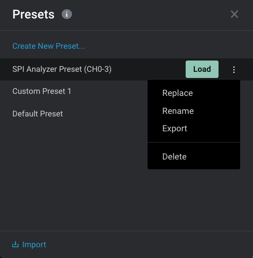

To open the Presets window, click File > Presets from the top menu.
Presets Menu Option
This will open the Presets window below. From here, you can manage capture setting presets for the software. To share your presets with others, you can export your preset and import it into a new PC. Click on the 3 dots to the right of your preset to open up the options menu for that preset. This will allow you to load, rename, export, or delete you preset. To import a preset, click the Import button at the bottom of the Presets window.
