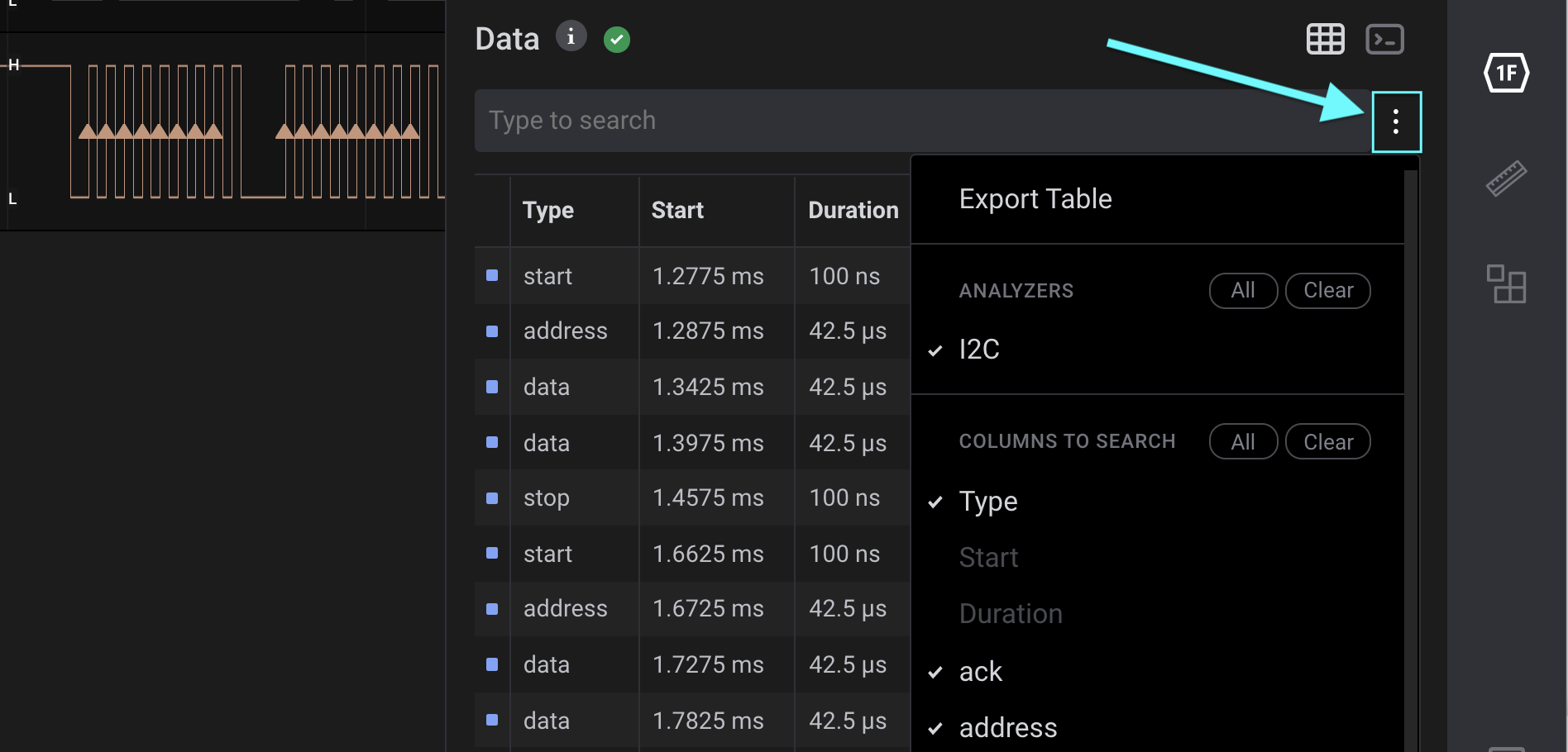

Excluding Analyzers and Columns
By clicking the 3 dots to the right of the search bar, a few options become available.
- Analyzers can be added or removed to exclude certain analyzers from search results and from appearing in the Data Table.
- The ability to exclude columns from search become available (while keeping them visible in the Data Table). This is useful for excluding columns that may otherwise pollute your search results, such as the ‘Type’ column, or boolean columns like ‘ack’ or ‘read’.

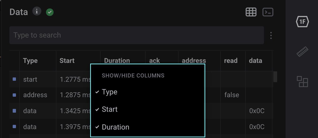

Show/Hide Columns
The ability to hide columns altogether is available by right clicking the column label in the Data Table.
This also excludes them from the search results and is useful when there are too many columns to comfortably display.

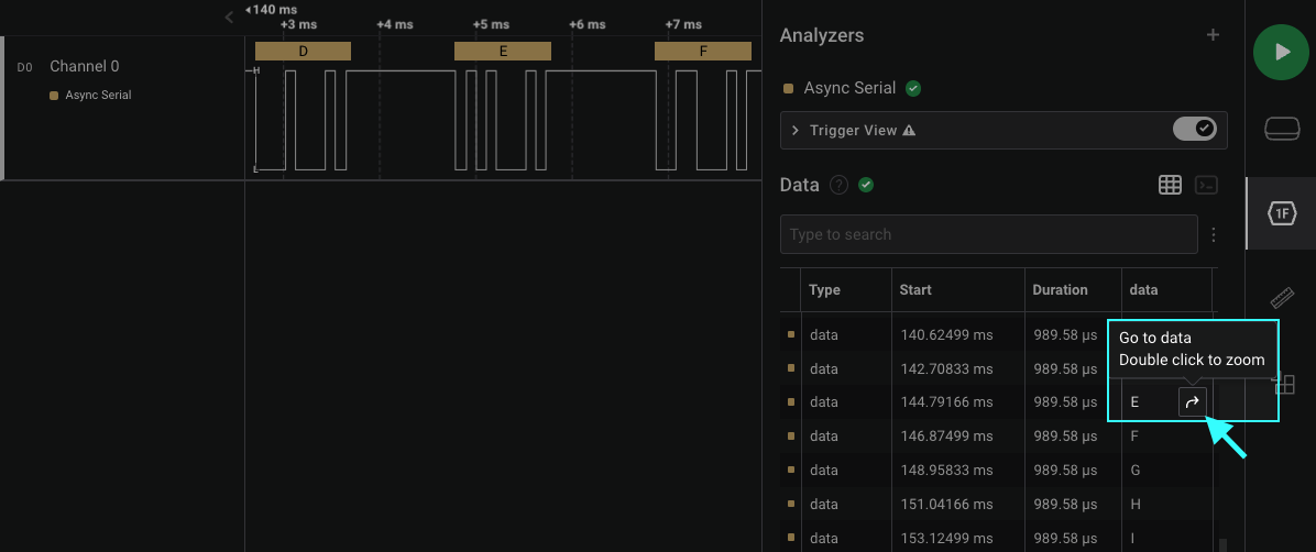

Jumping to a Waveform Bubble from the Data Table
You can jump to a specific decoded bubble above the waveform from the data table by hovering your mouse over the data table row of interest. An “arrow” icon will appear to the right of the data table row while hovering over it. Click on the “arrow” icon to have the waveform view jump to the appropriate waveform bubble of interest.

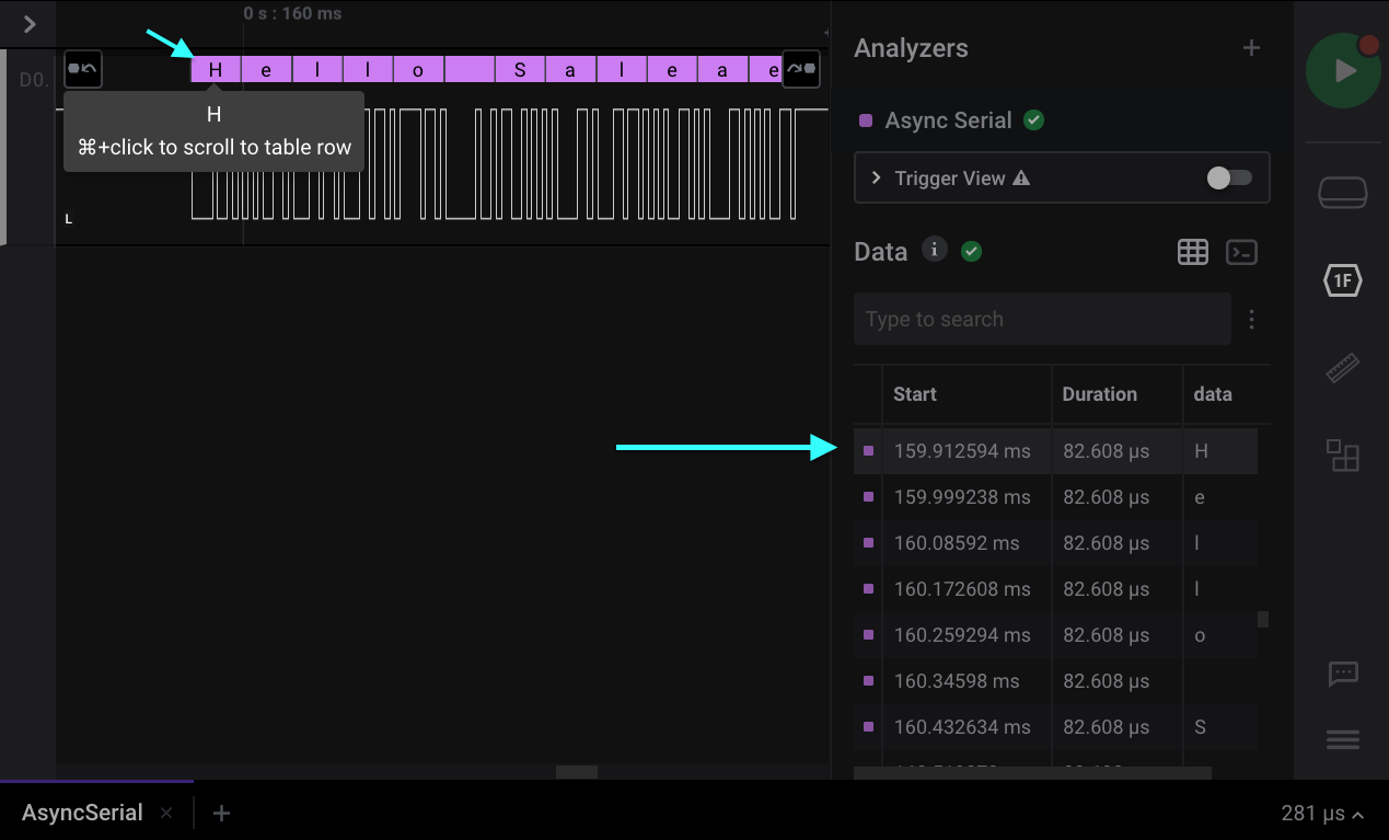

Jumping to a Data Table Row from the Waveform
You can jump to a specific row in the data table by hovering your mouse over a decoded bubble above the waveform as shown in the image below. A keyboard shortcut (OS-specific) will appear to allow you to perform this action.

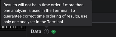

Terminal Output is not in Time Order
Currently, our terminal view does not output results in time order if more than one analyzer is outputting data to the terminal. Instead, our terminal view will group the output results by analyzer. We’ve received requests for adding support for ensuring time order when using multple analyzers. Please feel free to share your feedback on this in the feature request post here: Feature Request - Terminal Messages to be Timeline Ordered

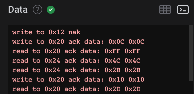

Radix Display within the Terminal
- Async Serial & Manchester - will always attempt to display in ASCII format. If the ASCII opcode doesn’t exist, then it will be displayed in hex, separated by backslashes (\) as shown below. Notice that the first set of opcodes (0 to 0x1F) do not exist and are therefore displayed as hex. As the opcode increments and become valid, ASCII characters are displayed.
- I2C - will display addresses and data, as well as read/write status, as shown below.
