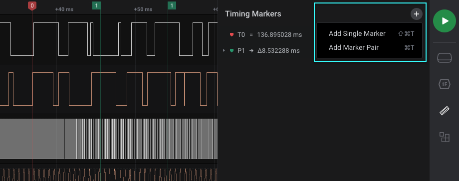

Timing Markers
Timing Markers in the Logic 2 software can be added via the “Timing Markers & Measurements” side panel button on the right. Two types of timing markers exist: (1) Single Marker and (2) Marker Pair.

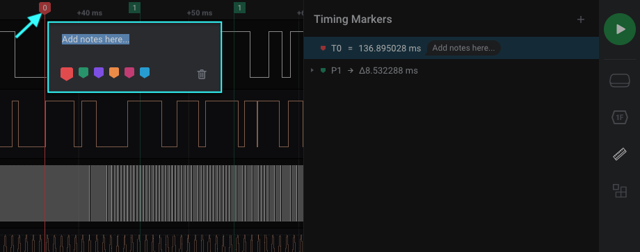

Adding Notes to Timing Markers and Editing Colors
By clicking on the timing markers at the top of the software, text notes can be added and colors can be changed. You can also delete timing markers from here by clicking on the “trashcan” icon.

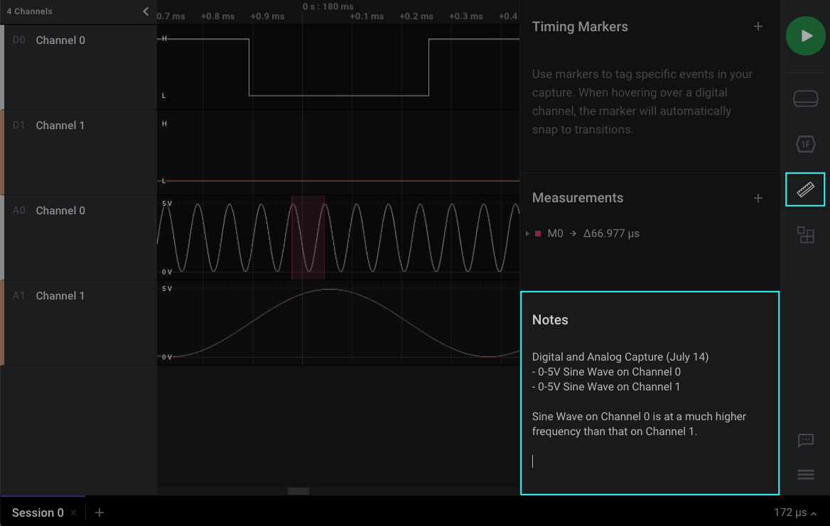

Capture Notes
A Notes section can be found in the “Timing Markers, Measurements & Notes” side panel button on the right as shown in the image below. This allows you to type in notes that are relevant for your captured data. The panel can also be resized both vertically and horizontally by hovering your mouse pointer on the separating edges of the panel.
