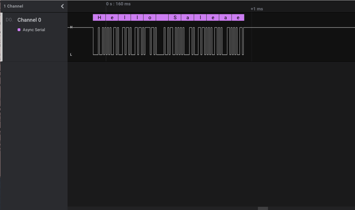

For example, take a look at the ideal capture case below. The capture begins before the data begins. Therefore, the protocol analyzer is able to decode the entire message correctly.

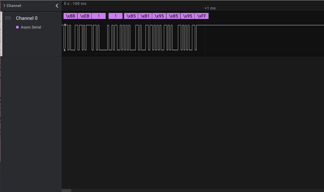

But… what happens if the capture began right in the middle of a data message, such as in the below image? In this case, it’s possible that all subsequent decoded data may be incorrectly decoded due to the offset this causes.
By deleting the portions of your data that might be causing this issue (most commonly the beginning of data captures being located right in the middle of a data message), this issue will most likely be solved.
