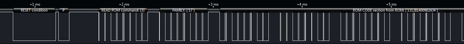

EditAs the name implies, 1-Wire has only one wire. The wire provides both power and low-speed data. Each peripheral on the bus has its own capacitor to retain power while the bus is low.
Example 1-Wire Parts
- 1-Wire Reset
- Presence Pulse
- Overdrive commands and data
- All Standard ROM commands
- Data Bytes
