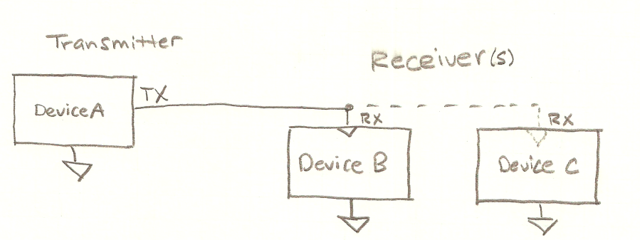

Topology – Where Do the Wires Go?
Async Serial data is sent with just one wire (not including ground). In most cases, there is one device that is the sender and one or more devices that listen.

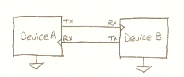

If communication needs to be two-way, then generally you need to add another wire for the other direction. These wires are often referred to as TX (outgoing transmission) and RX (receiving line) to convey their direction with respect to a particular device.

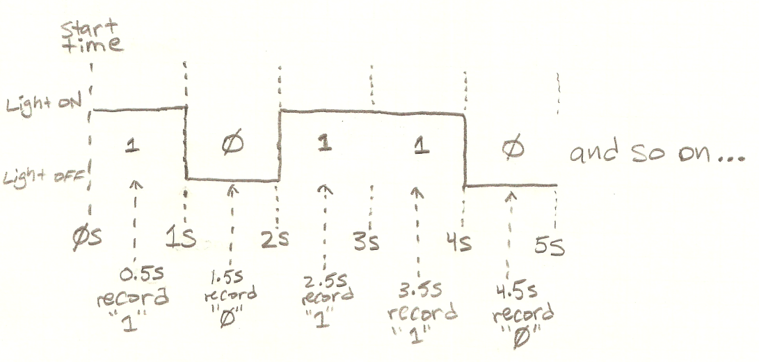

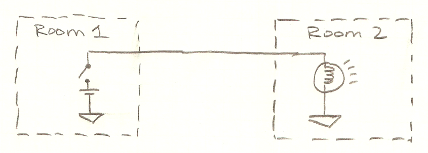

Sending Bits to a Friend in Another Room, Using a Switch
Imagine you are putting bits on the bus, once every second. You use a stop watch. Every second, you decide the next bit to send and then move a switch to either on or off (1 or 0). It turns on (or off) a light in another room. Remember, the light may or may not change every bit. Maybe you need to send a lot of 1s in a row. For example:
In the middle of each second (.5 seconds after the new bit is on the bus and .5 seconds before the next one), your friend writes down the value—1 if the light is on, 0 if the light is off.

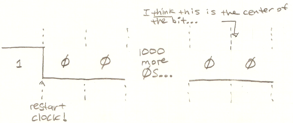

But What If the Sender Is Sending a LOT of 0s or a LOT of 1s?
If the sender sends a lot of 0s or a lot of 1s, then we wind up with the same problem. We don’t have a chance to resynchronize our cheap clocks.
You might think that won’t happen in real life or not very often, in any case. But remember, we need a solution that works in general for every situation.

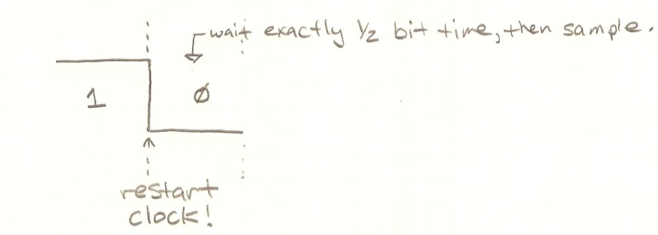

Both sides agree that the very first thing that will happen after Idle is that a start bit is put on the bus. The start bit has the value of logic 0—otherwise, it would be the same as Idle after all, and we wouldn’t have known it even happened.
When the Start Bit Starts—When the Logic Level Changes from 1 to 0—We Restart Our Clock
Remember, the start bit isn’t data that we’re trying to send. It’s ALWAYS 0. No useful data are getting sent here. It’s here to reset our clock and let us know that more bits are coming up.
The First Real Data Bit—The Bit That Comes after the Start Bit: What If It’s Also a 0?
How do we know when enough time has passed that we’re now in the middle of our first actual data bit? Simple: We time it. This is how the serial port on the IBM PC did it, and it’s how a PIC or MSP430 or Arduino do it.
