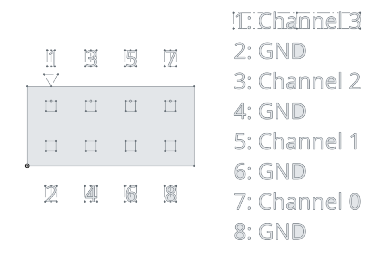

When using the Gen 2 Logic-to-2x4 header adapters, please use this pin out on your board (top view):

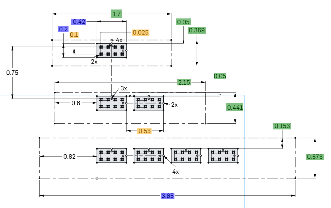

2. Add Female right-angle / Vertical headers to your PCB
You can add female right-angle headers to the edge of your board, or vertical headers to mount the logic analyzer vertically to your board.
Dimensions for the Connectors
Below are diagrams of the connectors on the new Saleae logic analyzers. Note that Logic 8 and Logic Pro 8 have the same dimensions.
The dimensions for the connectors on our Logic products are available on OnShape, named Saleae Pinout Gen2. A free account is required with OnShape to view them.
