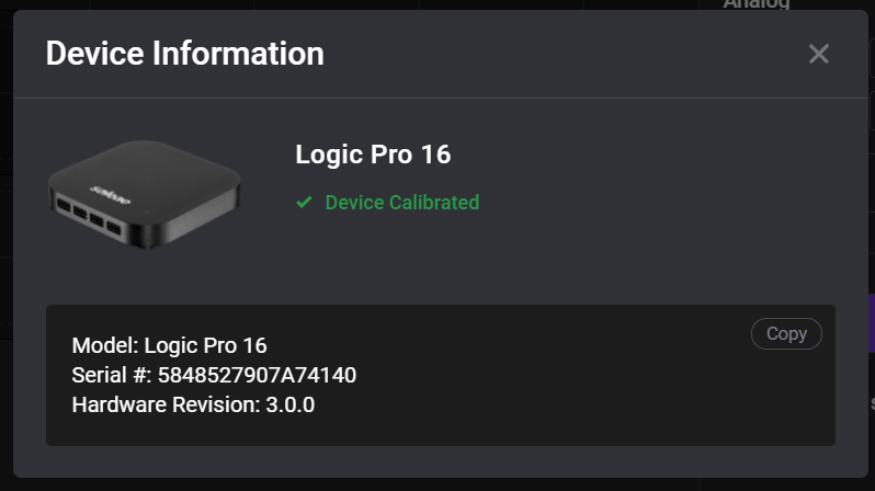

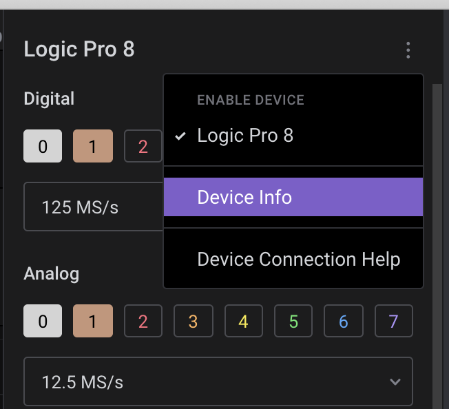

- Connect your Saleae device
- Open the device info dialog
- Check the hardware revision
