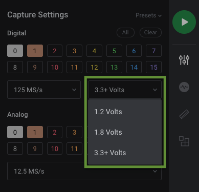

Logic Pro 8 and Logic Pro 16
Logic Pro devices have three selectable voltage threshold options. This setting applies to all the input channels simultaneously.
%20(1).png)
The inputs are also implemented with comparators instead of standard CMOS buffers found on Logic 4 and Logic 8. This makes the input-low and input-high voltages very close to each other. The exact behavior of these comparators is not defined here.
