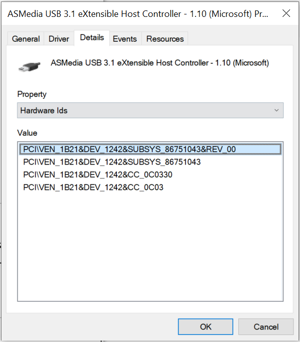

- Expand the section “Universal Serial bus controllers” and locate any & all USB 3.0 host controllers you find there. For each one, please double click to open the properties window, go to the driver tab, and send us screenshots as shown below.
4\. To better identify your host controller you are using, click the details tab, and select "Hardware Ids" from the property selection. Then take a screenshot. It should look similar to the below image.

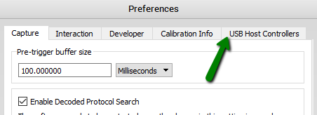

On Windows, the latest Saleae software has a feature to automatically retrieve this information.
First, open the options menu and select Preferences.
Second, navigate to the USB Host Controllers tab.
There, you will find a list of all USB host controllers installed in your system. Note: The “Status: Up to date” message is not accurate and is just a placeholder until we add automatic detection in a future software update.
For support finding the latest driver for your host controller, or on the request of support, please take a screenshot of the contents of this tab and send it to Saleae support.
