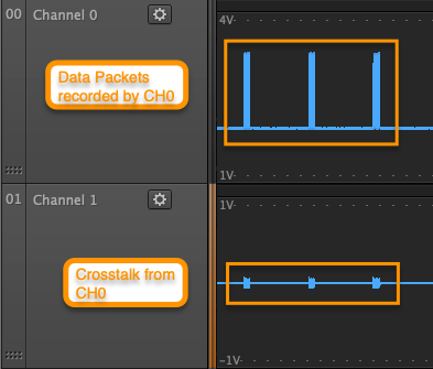

In the example image below, Channel 0 is recording a high speed signal, while Channel 1 is connected to the DUT Ground. You would expect Channel 1 to show a flat line to indicate ground, but due to crosstalk, this is not the case.
