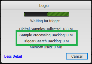

During the capture, press the “More Detail” link on the capture progress dialog. This will show the state of the capture and processing backlog.
- “Waiting for trigger…” indicates that the software has not yet detected the trigger condition. Once the trigger has been detected, the dialog information changes.
- Digital Samples Collected: This is the total number of digital samples that have been recorded by the device since the start of the capture.
- Sample Processing Backlog: Before the recorded digital data can be searched for the trigger, it first needs to be transformed into the data format used by the Saleae software. This backlog indicates if the sample processing system is or is not able to keep up with the capture in real time.
- Trigger Search Backlog: This is the trigger search backlog and indicates if the trigger search system is able to keep up or not.
- Memory Used: This represents just the memory used by the digital and analog data storage. It does not include protocol results or any other part of the software.
If the trigger is able to keep up in real time, the Sample Processing Backlog and the Trigger Search Backlog will stay at or near zero samples, possibly occasionally rising to as high as 10 million samples.
If either of the backlog indicators is steadily increasing, that indicates that the trigger is not able to keep up in real time and that memory usage is expected to grow rapidly.
