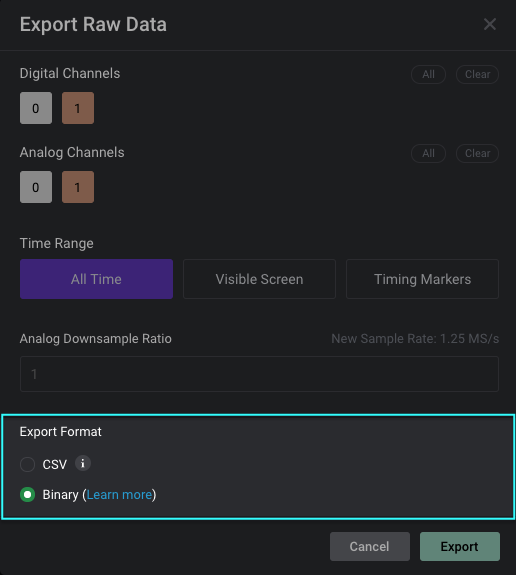

- Export to binary rather than CSV. We also have a sample python script to read binary data (provided in the link below, at the bottom of the article).

Exporting via Binary File - A Much Faster Approach
An alternative approach (much faster and produces a smaller file) would be to export to a binary file. More details on the binary file format can be found in the link below.
