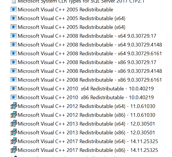

Instructions for Listing All Installed Microsoft Runtimes
- Open “Programs and Features” from the control panel or by searching for it on the Start menu.
- Scroll down to find one or more items labeled “Microsoft Visual C++ 20XX Redistributable.” Take a screenshot of all the items listed with this name and send it to support.
Example:
