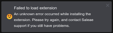

EditWhen starting the Logic 2 software, the following error message may appear.
Failed to load extension. An unknown error occurred while installing the extension. Please try again, and contact Saleae support if you still have problems.
