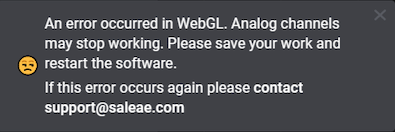

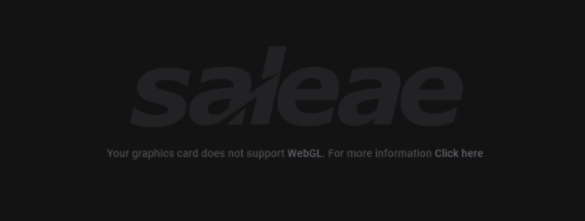

Upon launching the Logic 2 software, you may experience an immediate crash, or an error message may appear, stating either of the following:
Your graphics card does not support WebGL.Unable to detect WebGL, please contact support.
An error occurred in WebGL. Analog channels may stop working. Please save your work and restart the software.
