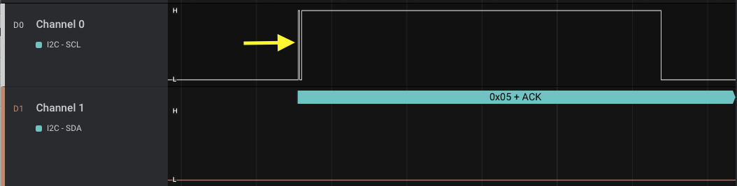

EditA glitch in data is usually identified by a relatively tiny, and unintentional, pulse in voltage as shown below. This can occur due to radiated noise caused by nearby electronics, noise in the circuit itself, extremely slow rise/fall times in the digital data, poor PCB layout, and many other reasons.
Glitch in the SCL signal
