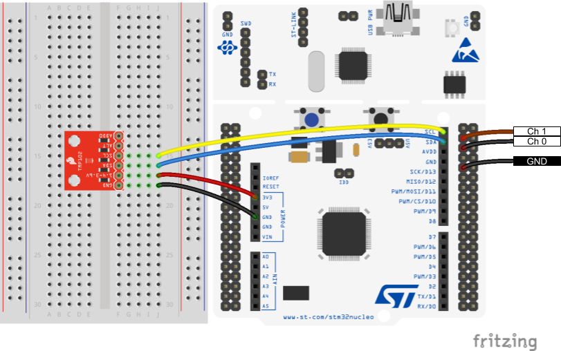

Solder header pins to the TMP102 breakout board, and connect the Nucleo to the TMP102 breakout board as shown in the following diagram. Note that GND, SDA, and SCL are broken out to the male pins to the right of the female Arduino headers on the Nucleo. This setup allows us to attach the Saleae Logic Analyzer wires.

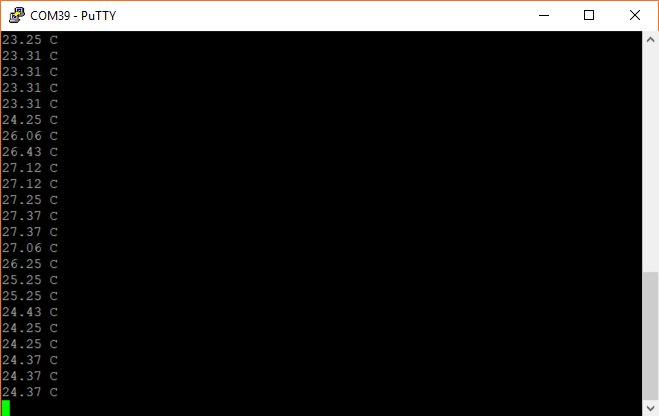

Connect to the Nucleo board over the assigned serial port with a baud rate of 115200, 8 data bits, no parity bit, and 1 stop bit (8-N-1). Open the connection, and you should see the temperature (in Celsius) being reported to you in regular intervals. Try breathing on the TMP102 sensor to change the readings.

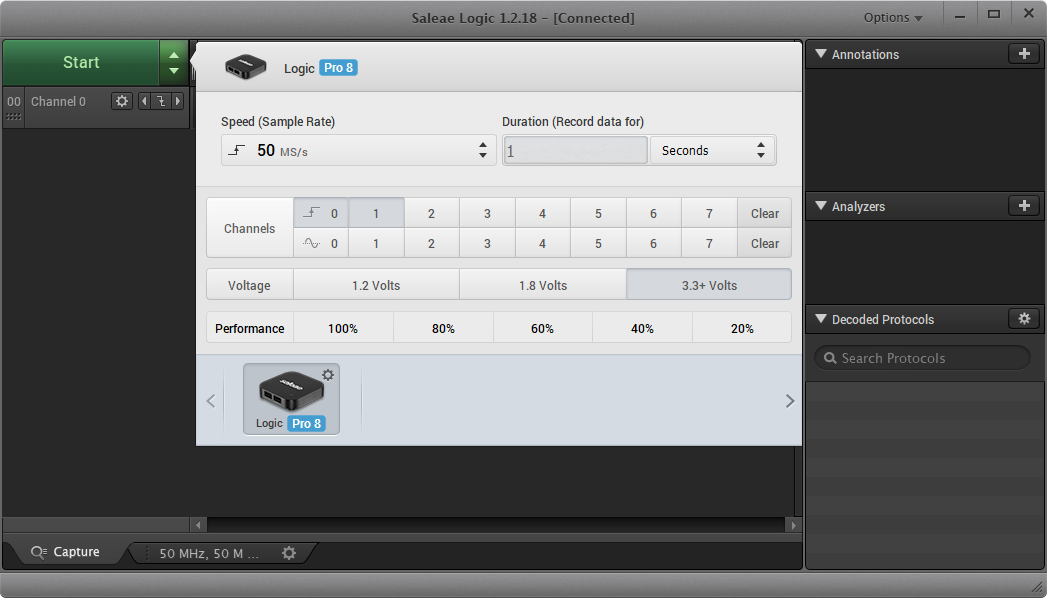

In the device settings window, set the speed to at least 50 MS/s and the duration to 1 second. Click both Clear buttons to disable all channels, leaving only digital Channel 0 enabled. Click digital Channel 1 to enable it as well.

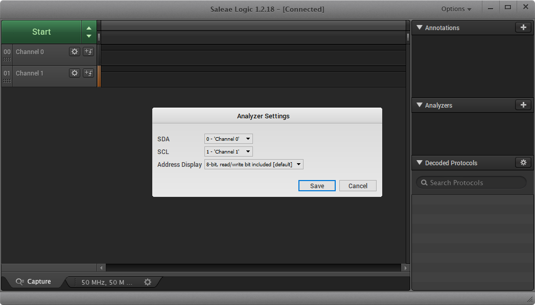

Set the protocol analyzer by clicking on the plus button (+) next to Analyzers on the right side. Select I2C to bring up the settings window. Leave everything as default and click Save.

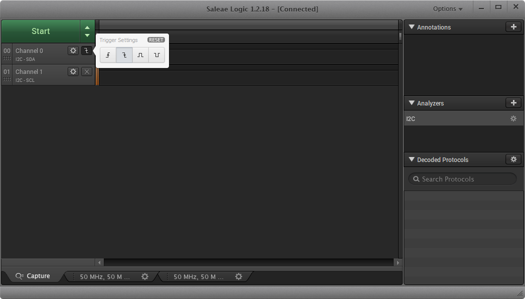

The data line (SDA) is normally the first signal to change during an I2C transfer. Because the lines are open drain, they will be nominally high, which means that we need to watch for a high-to-low transition. Click on the Trigger Button next to Channel 0 (I2C - SDA), and select the Trigger on Falling Edge option.
Click on the Trigger Button again to close the pop-up. Click Start to begin collecting data. Because we told the Nucleo to read from the sensor every 0.2 seconds, we should begin collecting data right away.

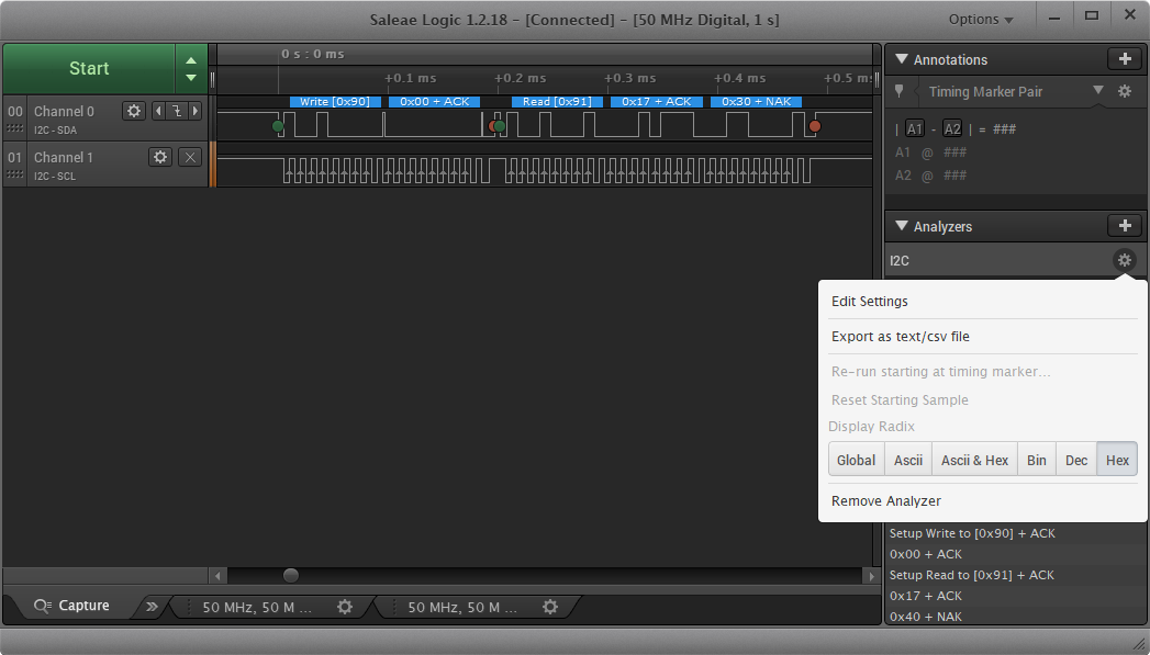

Zoom in around the 0 s : 0 ms : 0 μs mark, and you should see some I2C data. Click on the gear icon next to I2C under Analyzers. Click on Hex under Display Radix to show the interpreted data as hexadecimal.
You should see a write operation and a read operation. Both should begin with the address of the TMP102, which is 0x48 as a 7-bit number. If we shift it left by 1 bit, we get 0x90, and the last bit determines the type of operation (0 for write and 1 for read).
If you look at the write operation, you should see that the address is followed by the memory location of the TMP102’s Temperature register (0x00) and an ACK (line is low for 1 bit). Immediately following the write operation, you should see a read operation. Here, the microcontroller waits for 2 bytes to be sent by the TMP102. In the picture, the bytes returned are 0x017 0x30 (binary 0001 0111 0011 0000). The first byte is followed by an ACK (line kept low for 1 bit) and the second byte is followed by a NACK (line returned to high for 1 bit to indicate the end of the transmission).
This binary data represents the temperature reading by the TMP102 and is interpreted in the program to produce a human-readable result (in Celsius). Try breathing on the sensor to change the reading and see if you can capture the results.
