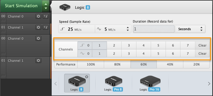

Check that the Channels are Enabled
The appropriate channels should be properly highlighted in the Logic capture settings as shown below.
