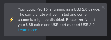

EditLogic Pro 8 & Logic Pro 16 can both be used with USB 2.0 or USB 3.0 ports. However, there are some restrictions when using them with USB 2.0 ports. In Logic v2.x, you will be prompted with the following message.
Your Logic Pro is running as a USB 2.0 device. The sample rate will be limited and some channels might be disabled. Please verify that your USB cable and USB port support USB 3.0.
